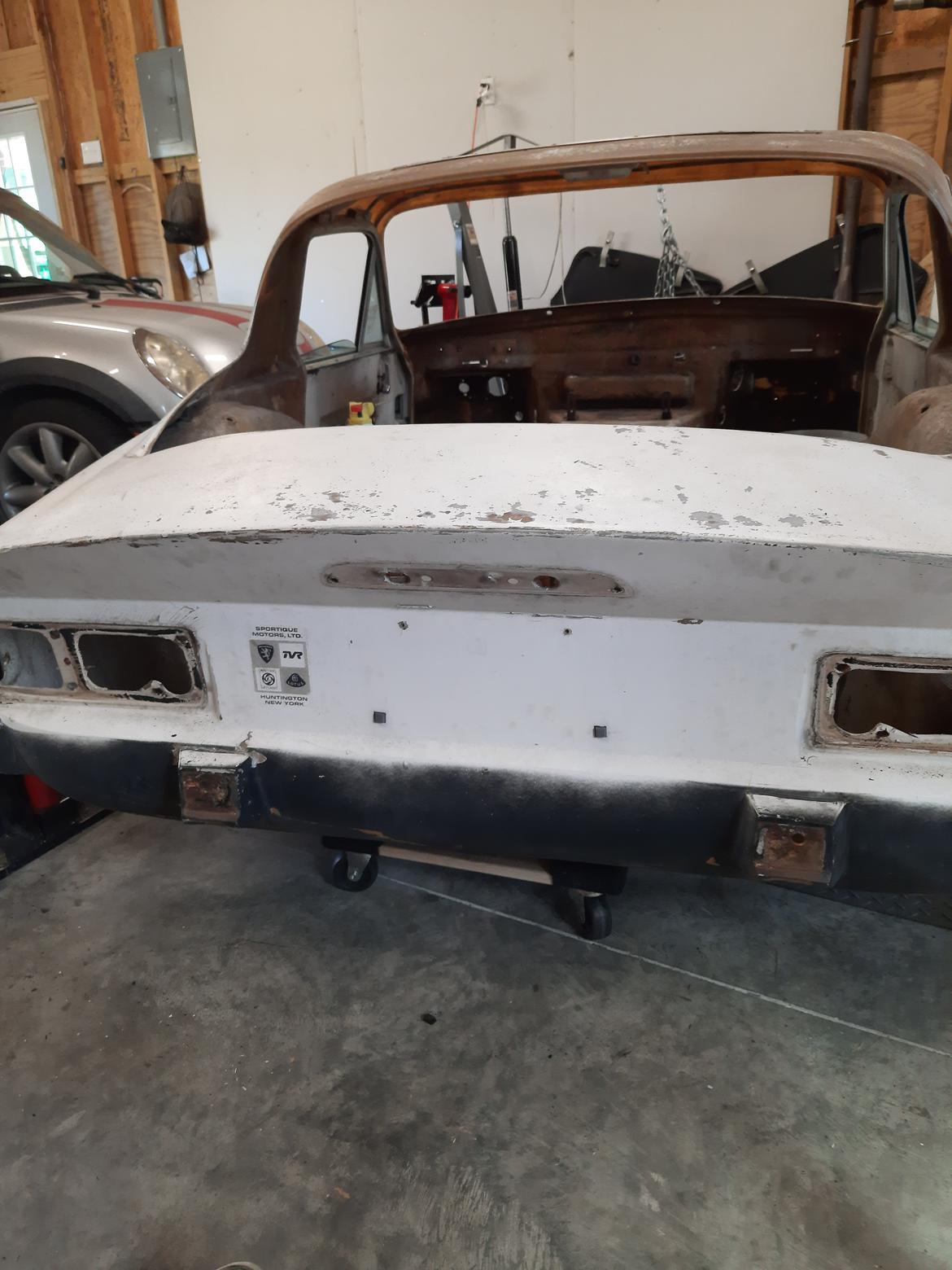

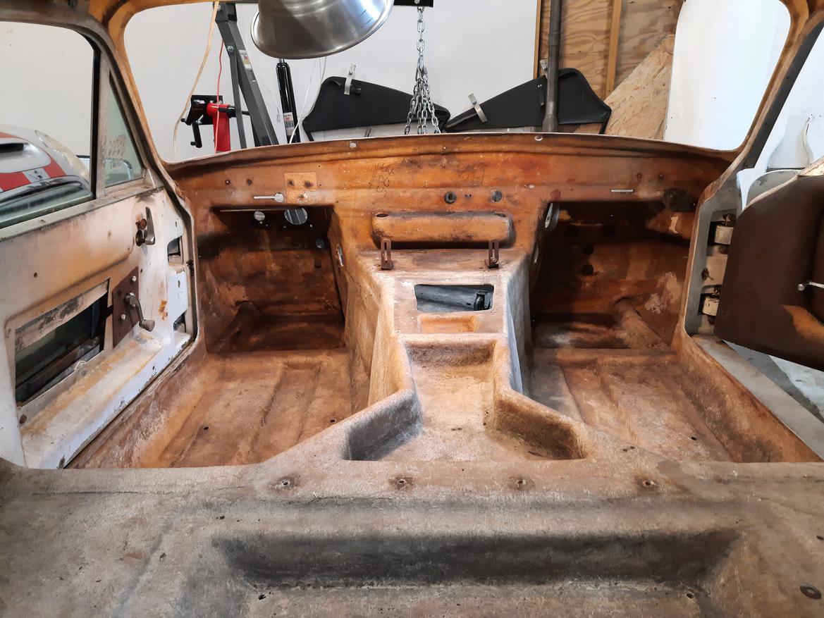

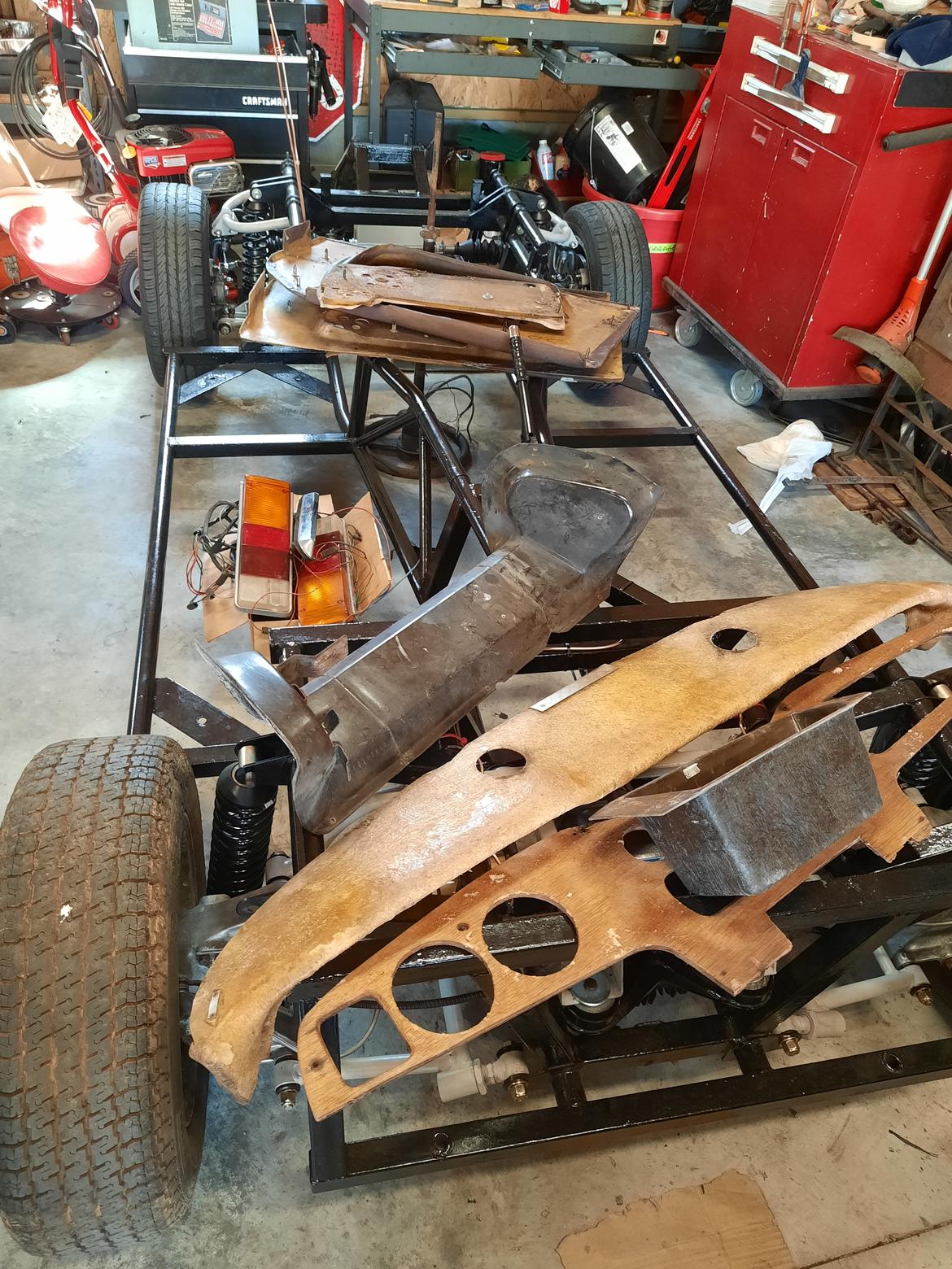

   It has been a while since the last update, but things have been going on with the TVR... or coming off, rather.  While waiting on the engine build I figured I should continue stripping the body.  Getting the peddle box out  meant getting the brake booster and brake/clutch cylinders out of the way, so I continued with that area and tried to get the dashboard out without too much destruction.  Not happening... the wood at the bottom was pretty much rotted away, but the brackets holding it onto the tunnel were solid, as in rusted solid. Had to cut the bolts off.  Then I tried to separate the dash (wood) from the crash pad (fiberglass). That didn't seem to want to work, so I figured out that the entire dash was held in by 3 bolts, one on each side and one in the middle coming through the firewall  (other than those into the tunnel). An oscillating hacksaw got them out, and the dash structure was free!  But that just exposed this...

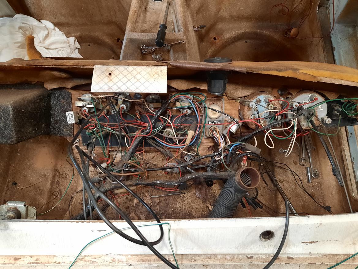

A lot more wiring than under a Triumph TR3 dash!  I know a lot of that mess will not be staying, and I intend to rewire anyway, so I cut off the fat harness going through the firewall and just pulled it all out of there. The interior got much less cluttered with that gone.  Then the wiper motor and assembly came out, and the hood latches were removed.
That left the heater chamber ("plenum"?), which is a fiberglass panel screwed into the firewall and sealed with a fat bead of putty.  TVR used a bunch of fairly small flat-head screws for this, and they were hard to remove without shredding the heads. But, with that out of the way the engine bay is pretty much cleaned out for bodywork and painting!
You can still see the battery platform in that photo, but that's gone now.  Also pulled the panels from the passenger door.  Moving to the rear of the car, the only remaining wiring is to the tail lights and gas tank. The tail light assemblies seem to be in pretty good nick, but once again the nuts holding them in place were rusted and most bolts just broke off.  Still, the lights are off and the remaining harness was yanked free.
Looks a little naked now.  The piles of parts are getting taller.  Boxes of wiring and lights, gauges to be rebuilt, interior panels to recover, starting to overwhelm the build.

My future self cringes more than a  little at the pics of your dash.  I've been pretty good at ignoring that so far.
Looks like good progress, though.
4/5/21 10:59 a.m.
For the doors i would strongly recommend lube and working them to free them up. Ive never been happy with a door ive completely disassembled and rebuilt. I just don't have the knack.
Glad to see a bare tub! Its all easier from here. Parts going back together is fun! And that woring looks standard for the era. It'll be a lot better reassembled and rewired.

Actually, the wiring won't be all that bad.  that silver thing with about a dozen wires going into it is a warning buzzer... for seat belts, ignition, etc. It'll be gone.  Also all that red wire is to instrument lighting, and a lot of the black (and white, go figure) seems to be grounding for all the instruments.  Too many idiot lights too!  It will be simplified dramatically.  As to the doors, I'm sure I can get the windows to work OK without disassembly, but it looks like any seals along the tracks and sill may need to be accessed from within.  I'm also considering replacing the exterior door pulls, which are pretty pitted.  I believe they are Ford Cortina originally, but it's a fiberglass door, so any donor could do... maybe MGB, Spitfire, heck maybe Ford or Chevy!  As long as they can integrate with the  latches.
