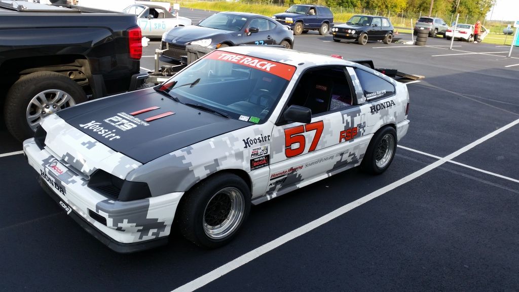

Tons of fun but got murdered by the national level CRX. They were so together all day and were amazingly smooth.

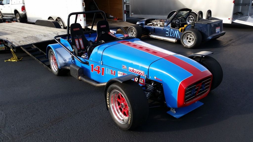

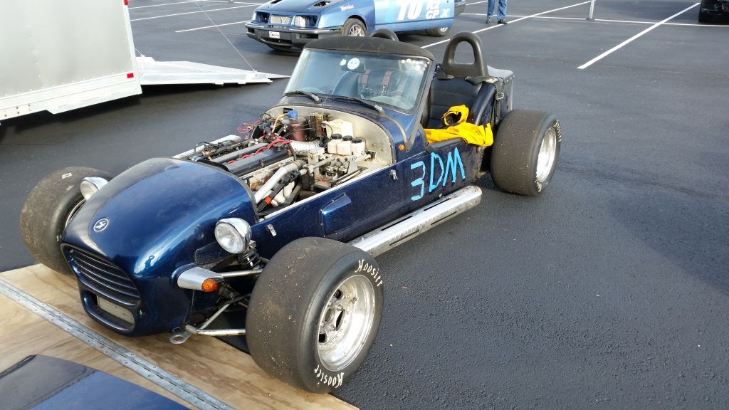

Few pics for you...
