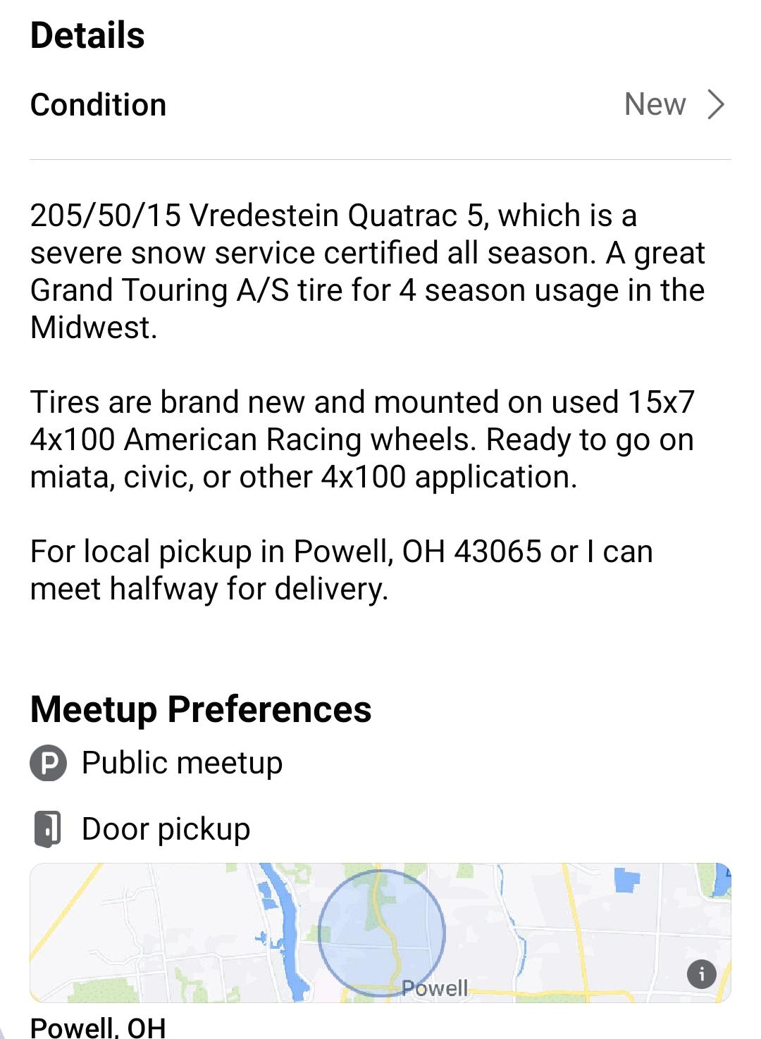

After the dashcam in the BRZ, I moved on to wheels and tires I bought on Facebook Marketplace Monday. I spent more time with a lugnut jammed in the socket than anything else.
$400 for 4 new tires and wheels seemed like a good deal. No more 6 year old rubber, and now some decent winter tires. Not really for deep snow, still have the Crosstrek, but I feel more comfy driving in the non-warm months now.
