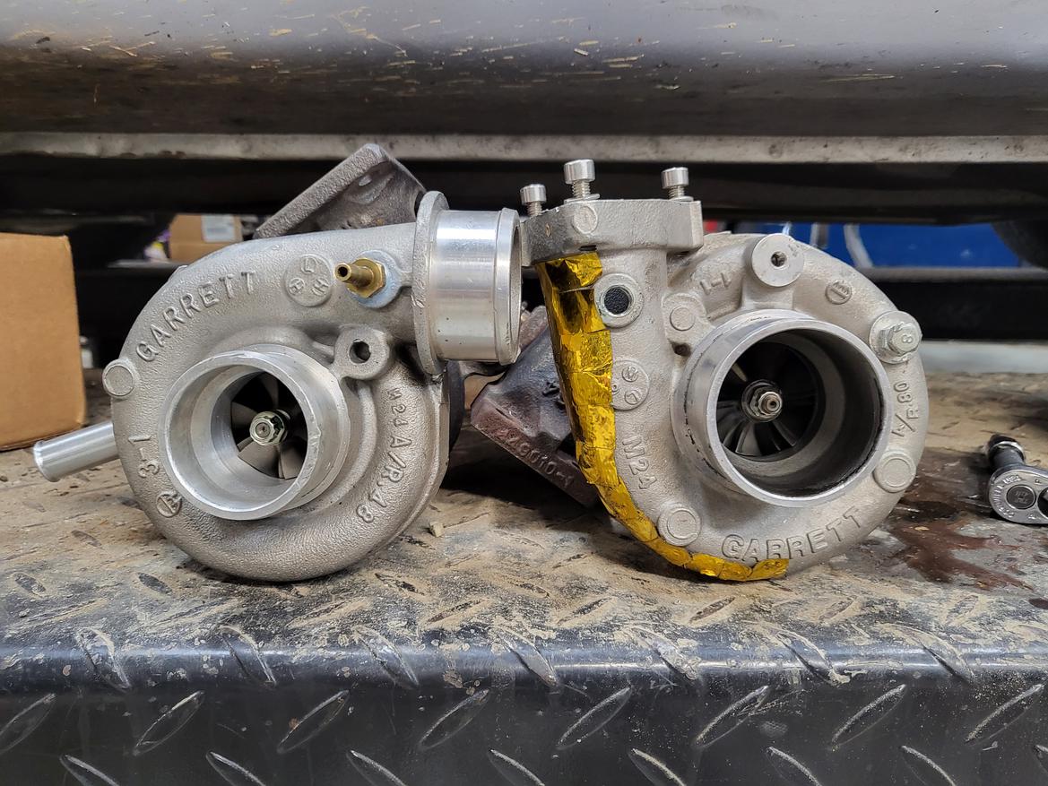

malibuguy
malibuguy GRM+ Memberand HalfDork
9/9/22 8:27 a.m.
The last handful of days have been stressful.
Bought a Maxpeedingrods 'GT28' to try to finish the season off and experiment with a larger turbo to see if its a path worth pursing.
After spending a whole day modifying, prepping and fitting the turbo...turns out it was machined wrong or something.  Spins freely when cold, but after approximately 10seconds of run time it locks up.  Once it cools down it spins again.  Fire it up...10seconds later locked up.  Rev the piss out of it...doesnt matter.  Its like they didnt compensate for thermal expansion.
Before you react.  I KNOW its a china turbo.  I didnt expect 100k of use out if it...but more then a minute.  I really only wanted it for a month or 2 for testing and use.
So I then realized my pair of Garrett GT1548 turbos I bought about 10 years ago (i seem to have bought alot of turbos 10 years ago) also had a t25 inlet flange I quickly picked the best one and began making it work.  Quick look at the compressor map and I should be just within the sweet spot but near out of turbo.
I had to make a downpipe flange since I didnt want to wait.  That also meant I had to make another downpipe.  So I whipped one up with some left over aluminized steel mandrel bends.  I am not a fan of silicone bends but for now I am using one just to make things work.  Also had to make a new intake pipe.
BUT it works...and rather well surprisingly to me.  As expected the much smaller turbine responds VERY well and doesnt feel like its choking it off that bad.  That being said its very OEM feeling but definitely not an open lapping turbo.
Right now I am trying to remap the boost controller...as it wants to go to 21psi of boost...it has a very small wastegate port that I ported as much as I felt comfortable with.
I also have some thermal zero products coming to control the heat.  After my first test drive I realized how much spooly noises this turbo wanted to make.  So i removed my Dynomax SuperTurbo muffler and made a new rear section using a Flowmaster resonator from a Tundra exhaust kit.  Makes it sound like a SRT4 in a good way.  Very deep, throaty and gargles, motor sounds like its got a big arm.  And all the spooly noises.  Best part.  Absolutely no drone.
