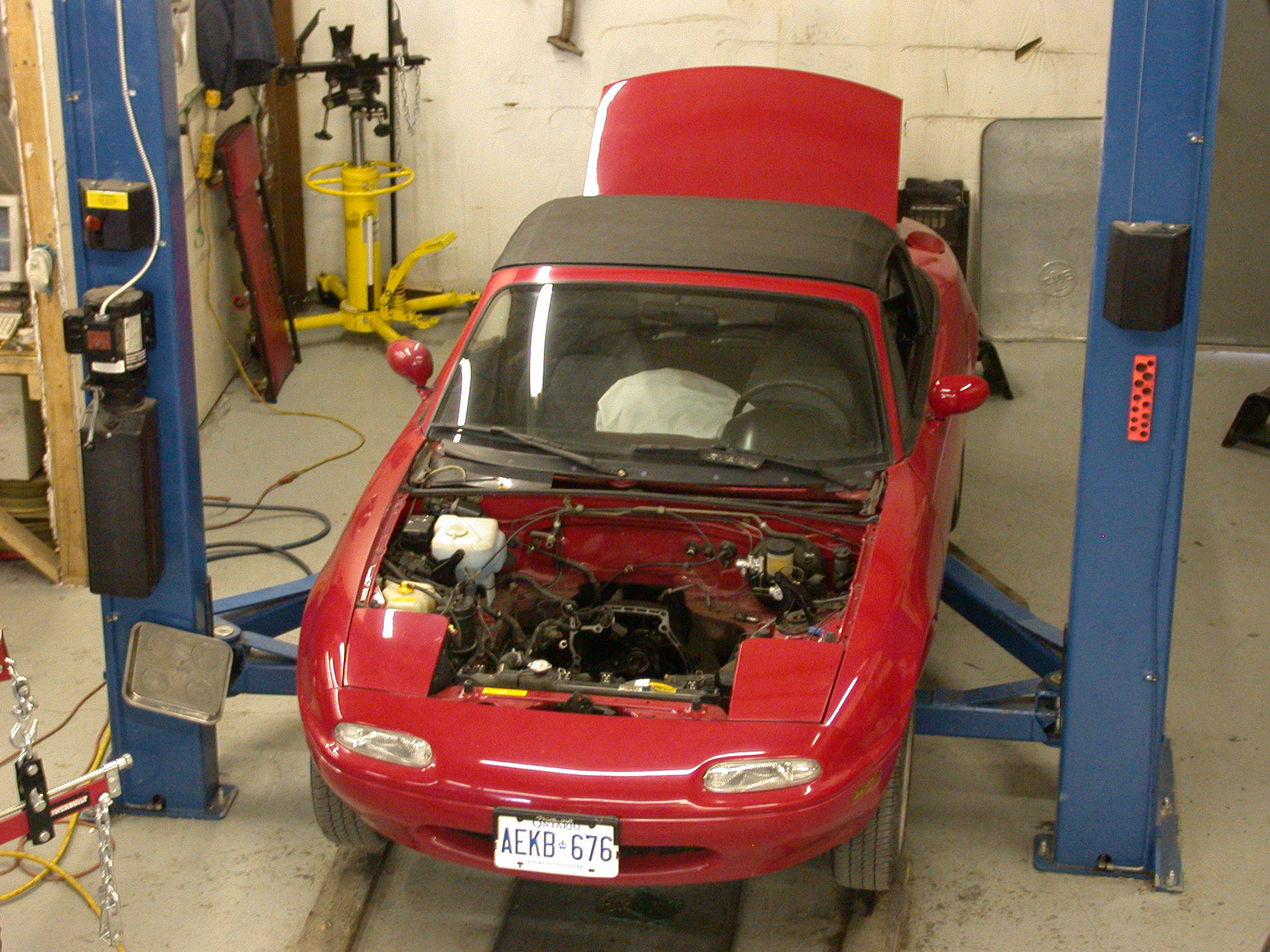

That's a historical photo! I did not just tear the engine out of the car :) Read on...
The suspension testing went well, with a number of the FM staff preferring the suspension on 338 over the new tech. We'll see where that goes, but it's good to know the old girl can still hold her head high.
What was interesting was driving a 1994 survivor back to back with 338. The 94 just got new shocks, new bushings and a 60k service and was otherwise fairly stock. But it had a cracked dash that rattled and that made a big difference in how old the car felt. Overall, it just felt more tired. I know the owner is just getting started on refreshing the car, so hopefully it'll come together. Also, the 1990 interior is so much classier than the 1994-97, always has been :)
Coker says the new tires (Michelin Pilot Exalto for those who forgot what I ordered back in January) are due to be in stock at the end of March. Let's hope!
And, apropos of nothing in particular, I came across a shot of 338 getting the engine rebuild. Dad drove the car out to Colorado and left it for the winter while it would have otherwise been in storage, then he and Mom took a road trip home. The picture is dated April 7, 2002 so we're looking at almost exactly 21 years ago. It's the first engine I built and it seems to be holding up okay. It's still got the original head/block/etc because Dad wanted to keep it numbers matching, although the only number is riveted to the oil pan.

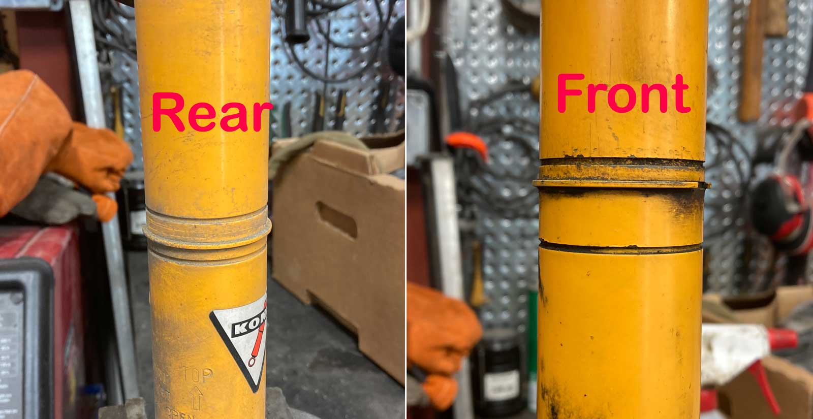

I realized during our suspension testing that it looked like the rear of the car was sitting little lower than I'd like. I grabbed the tape measure and discovered the car was at the same height front and rear - usually the measurement I use has a 1/2" (12.5mm for the metric crowd) higher rear height. The Konis have three possible perch positions: stock, R Package and "lowered". The middle one matches the perch position used on the 94-97 R Package Bilsteins, and that's where the car was set. I would have put it there back in 1999 when I installed them and didn't pay any attention when I had the shocks out recently. The ride height measurement is actually where I understand a stock R package sat, so I guess they were correct.
I decided to lift the rear up to stock height and leave the front where it is to get my rake back. Easy enough, just pop the rear shocks out, remove the spring and move a circlip. And I'd never noticed this before, but the drop for the R package is greater in the rear than the front. There are different motion ratios, but look at the relative gaps between the three positions. Picture taken before adjustment. I am now at the top setting in the rear and the middle setting in the front.
Measurements say the operation was a success, I have my 1/2" rake back. If I was selling coilovers, I'd say that I decreased the preload but I'm not confusing cause and effect here :)  I also found an upper mount that had slipped a bit so I swapped it, I think it's time to get four new ones instead of digging through my stash for the least worst one.
