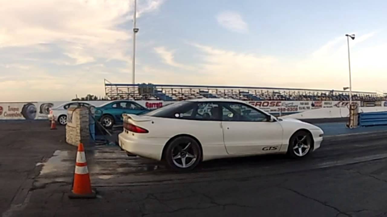

I seem to recall a Probe GT V-6 that the guy went to great lengths to convert to rwd/longitudinal.
That's all I got
