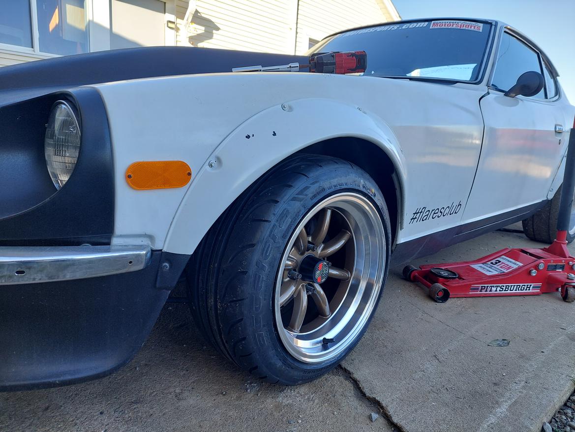

No one has any input on 16" vs 17" tires for this use?  I'm still undecided.  I'm also undecided if I should buy some JDM forged wheels or refurbish and get the ones I have refinished.  Or should I just spray paint them gold and send it.  I won't cry if they get hurt doing the later.

As someone running these sizes in 16" I like that the tires (and likely wheels) are more affordable. I don't like that the taller sidewall doesn't support the tread as well during hard cornering on track and flexes more, that is likely a plus in your usage case.

The 16s will be better for rallycross, the 17s will be better for everything else. Also there's a much better selection of tires in 17"
