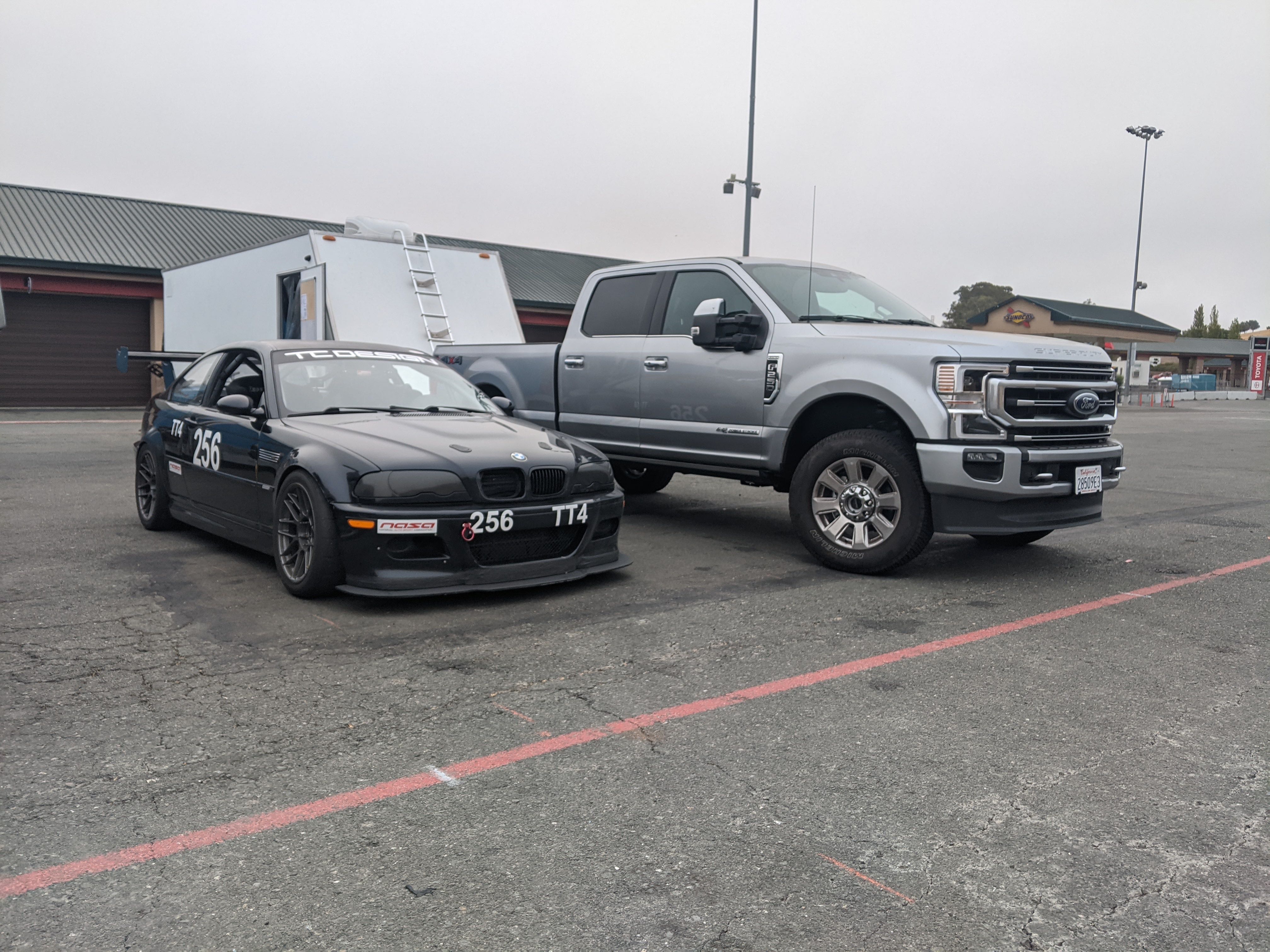

Not sure how helpful this is, but I've been very happy indeed with my 2021 F-250 powerstroke.  Tows great, and is a much quieter and more comfortable place to be than any other tow vehicle I've driven.  It really helps with the fatigue and long tows home after an event.  I'm not sure how much that applies to the previous generation that you're talking about, though.
Strangely all the photos I have of it have a BMW parked in front... :)
Between your two options- I haven't had any more issues dailying an F-250 than I did with an F-150, although the mileage is worse. I also tow an 8k enclosed race trailer and the F-250 is MUCH better at that job but technically I didn't "need" it, the F-150 did an OK job. I got tired of constantly messing with the weight distributing hitch.
