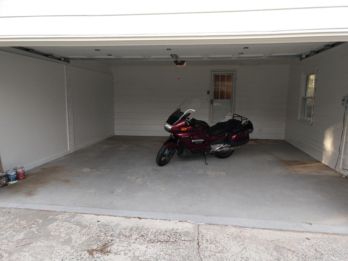

Speaking of the new house, it fits exactly one (1) ST1100. With a little luck and some carefully maneuvering, I might just be able to squeeze one other bike in.
